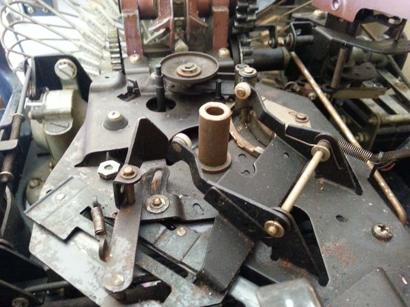

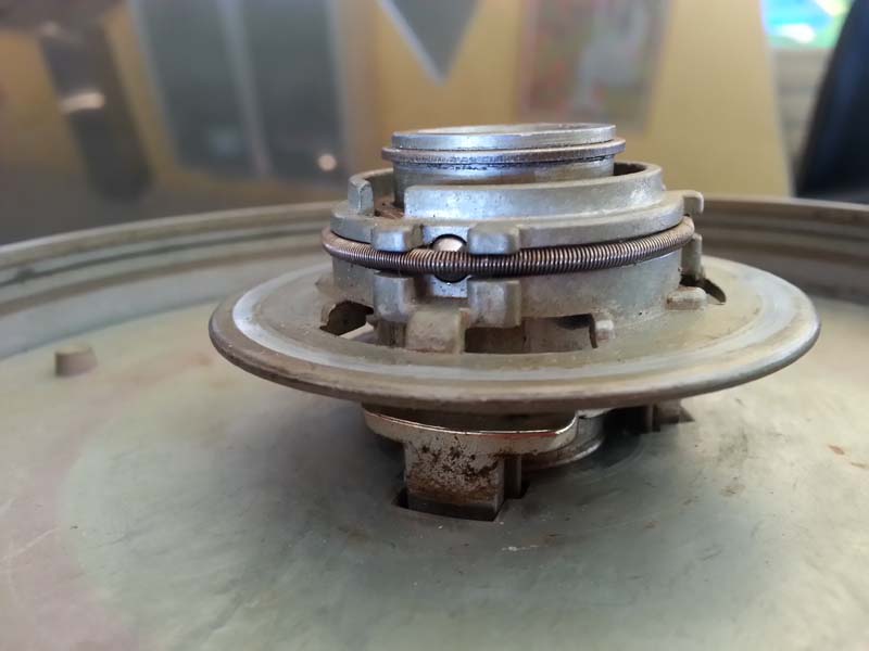

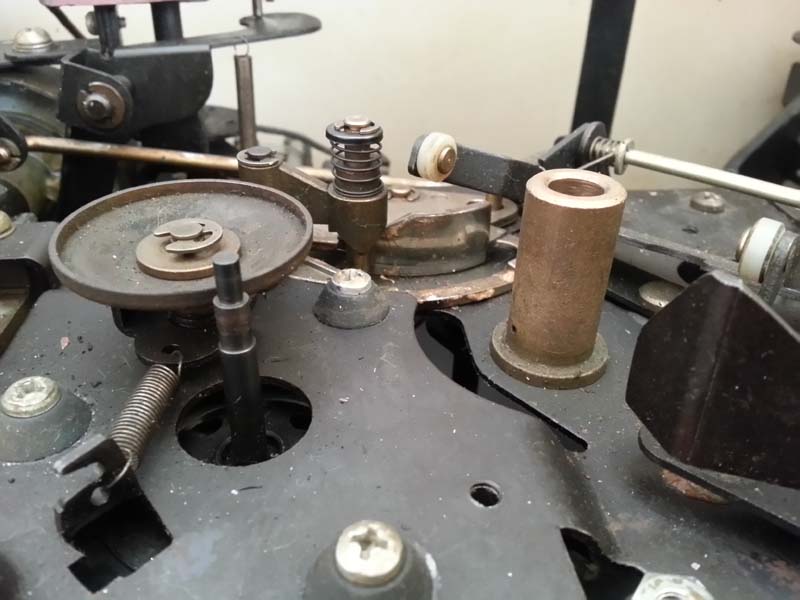

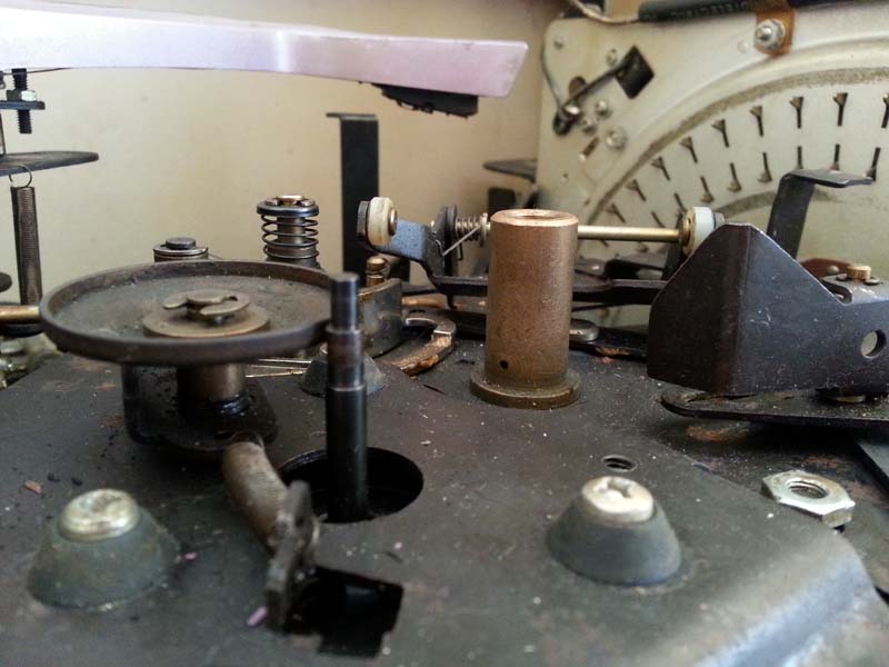

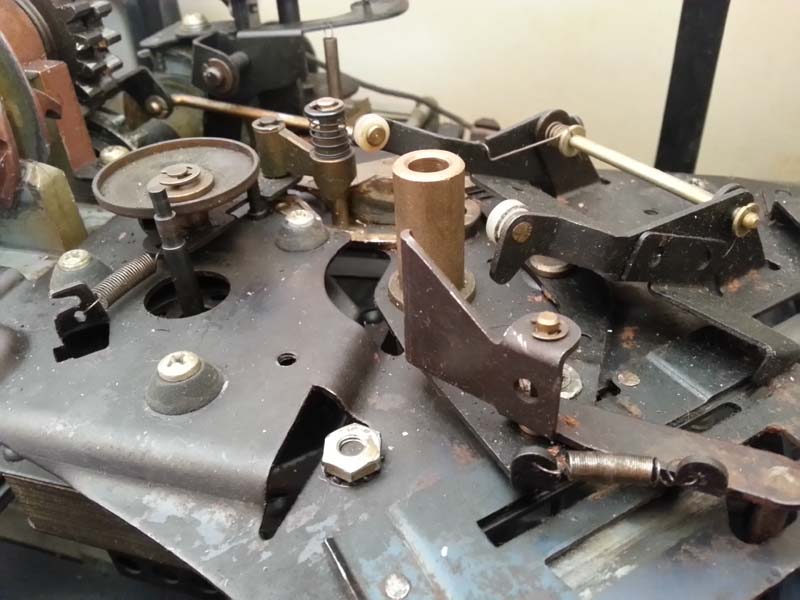

Fotos einer sog. Intermix-Einheit am Beispiel einer Rock-Ola 430.
There were records availabe with more than one title per side, 33-1/3 rpm and a small center hole, comparable to the EPs or similar to the quartet records in the GDR (note: But with 45 rpm and a large hole). These so-called albums needed to cost more, and so the corresponding function was set up in the credit unit. The mechanism then recognizes, if equipped accordingly, the size of the center hole and switches the speed accordingly.
However, the two functions are independent of each other. There are therefore jukeboxes with the album function in the credit unit, but a pure 45 rpm mechanism.
Photos of a so-called intermix unit in a Rock-Ola 430 for example.

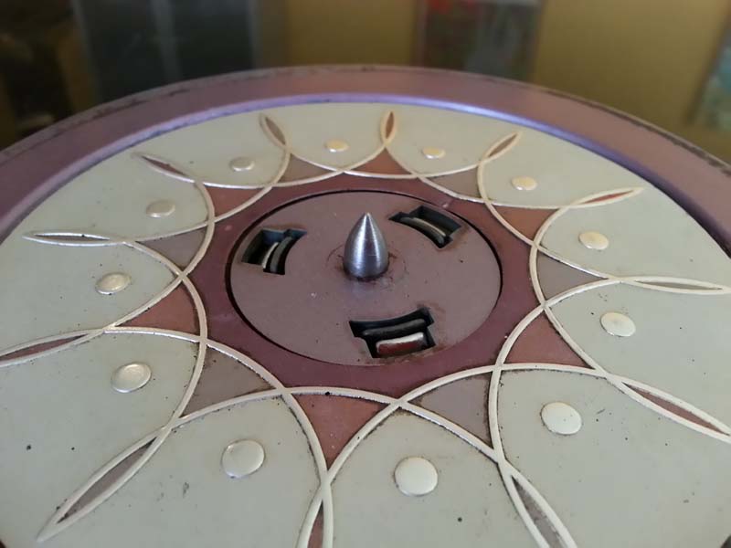

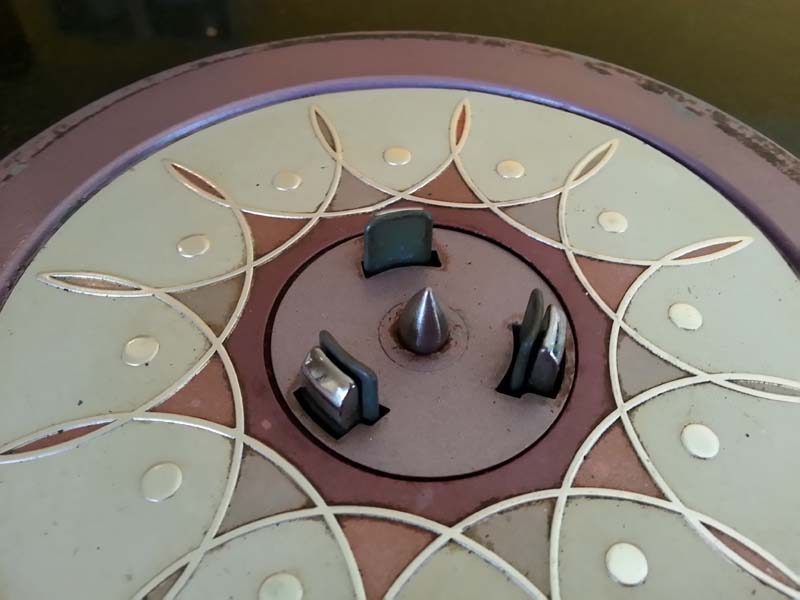

Mechanismusabdeckung Rock-Ola Regis und Empress mit 33/45 RPM Umschaltung   Mechanism cover Rock-Ola Regis and Empress with 33/45 Intermix
Bilder und Information: Axel Rosenberger
Es gab "normale" und 33/45 RPM Abdeckungen, wobei sich Regis- und Empressabdeckung in einem kleinen Detail bei beiden Varianten in der Nähe des Tonarmdurchlasses unterscheiden.
Die Empressabdeckung hatte dort einen kleinen Wulst um der Schubstange, die für die 33/45 RPM Umschaltung benötigt wird, Platz zu bieten.
Die Regisabdeckung hat diesen Wulst nicht und hat auch anders geformte Deko-Einlegebleche an dieser Stelle.
There were standard and 33/45 RPM covers available, whereby the Regis and Empress covers differed in one small detail in both variants near the tonearm passage.
The Empress cover had a small bulge there to provide space for the push rod required for the 33/45 RPM switchover.
The Regis cover does not have this bulge and also has differently shaped decorative inserts at this spot.

Rock-Ola Regis "Mech-O-Matic" 33/45 RPM Intermix
Fotos: Erich
Rock-Ola Regis 1488 1495 Intermix
  33/45 rpm intermix in Rock-Ola 430
Photos courtesy of Marcel C.
Rock-Ola 430 Intermix Mech-O-Matic
