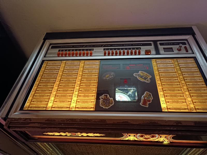

Wahlen / Selections 100 - 45 rpm
Lampen / Lamps Select: GE #53   |    Cabinet:   TL 25 Watt / 28" / T12   |   Power supply: GE #309   |   Amplifier: #GE 313
Verstärker / Amplifier 48350-1A
Netzteil / Power supply US: 48445-A   |   D: 48460-A   |   B: 48465-A   |   GB: 48590-A    |   AUS: 48470-A   |   Japan: 48450-A
Kreditgerät / Credit unit 50635-A (Std)   |   50640-A (US)
Lautsprecher / Speaker 2x 6" 16 Ohm: #50744   |   2x 10" 8 Ohm: #50545
Tonabnehmer / Cartridge Shure M44R with stylus Shure N44C
Sicherungen / Fuses Credit Unit: 250mA  |  Power Supply Germany: 1A, 3A |  Power Supply US: 5A, 3A
Amplifier 2x 3A, 2x 240mA
Schlüssel / Key F-592
Abmessungen / Size B x H x T: 86 x 112 x 60 cm; 115 kg
W x H x D: 44-1/4" x 34-1/8" x 23-1/2"; 230 lbs
Zubehör / Accessories Aux. Wallbox Power Supply 2121
Wallbox Tri-Vue 507 with stepper 1769
Microphone Kit 2130
Motorized Remote Volume Control (w/o On-Off): 2173
Motorized Remote Volume Control (w. On-Off): 2156-1
Manual Remote Volume Control 2122
L-Pad 2171   |   Intermix 2152   |   Multi-Pricing Adaptor 2172
Kit 2138   |   Microphone Kit 2130
Wallspeaker 1635, 1636
Corner Speaker 1637
Ceiling Speaker 1638
Amplfier Conversion Kit 2174 (mono to stereo)
Besonderheiten / Features Uses old style of selection system by pressing both letter and number buttons, not three digits.
