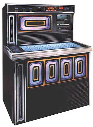

Rock-Ola 478 - Mystic
(1978-79) |
Aus der deutschen Werbung: |
From
the US brochure: |
| Wahlen / Selections | 160 |
| Lampen / Lamps | Cabinet: TL 25W/T12/33" | Pricing Board: 4x #53 | Amplifier: #1829 - Ba9s 28V/70 mA/2W |
| Verstärker / Amplifier | 52280-A |
| Netzteil / Power supply | US: 52390-A | D: 52405-A | CAN: 52395-A | Japan: 52400 | AUS: 52410-A |
| Kreditgerät / Credit unit | 52455-A |
| Lautsprecher / Speaker | Low 2x 12" | Mid-High |
| Tonabnehmer / Cartridge | Shure M44 |
| Sicherungen / Fuses | PC Boards: 2A, 2x 1A | Power Supply: 800 mA, 250mA + US: 5A | D: 3A | CAN: 5A + 250 mA GMQ |
| Schlüssel / Key | P-600 |
Abmessungen / Size |
H x B x T: 104 x 137 x 63 cm |
H x W x D: 40-5/8 x 53-9/16 x 24-9/16" 146 kg | 325 lbs |
Zubehör / Accessories |
Stepper
1775 with wallbox
507
or stepper 1780 with wallbox 508 Microphone Kit 2130 2121 Aux. power supply; 2122 Manual remote, 2156-1 motorized remote (w/ on-off switch), 2173 motorized remote (w/o on-off switch) 2300 Deluxe Wall Speaker Money and pricing kits 2196, 2197 and 2199 |
