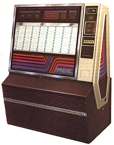

| Rock-Ola 480 (1979-80) ••• Rock-Ola 484 (1980-81) |
160 selections Spain: distributed by Famaresa |
| Rock-Ola 480 - Techna | Rock-Ola 484 |
| Technische Daten - Specifications 480 and 484 | ||
