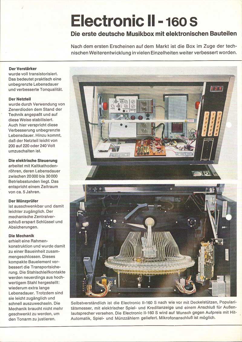

Technische Daten -
Specifications Electronic 160 &
Electronic 160 II |
Electronic 160 |
Electronic 160 II |
Wahlen / Selections |
160 |
160 |
Lampen / Lamps |
Cabinet: 1x
TL 13W / 21" / T5
Credit: 1 Kaltkathodenröhre ZA1000
Turntable: E10/3V/0,25A/0,75W Case with titlestrips:
Tubes E14 220V/40W - Größe 3
Record indicator: ZM1080 |
Cabinet: 1x
TL 13W / 21" / T5
Verstärker / Amplifier |
Klein & Hummel TS-64: 2x ECC 83, 2x ECF 80, 4x EL 86
Gleichrichter 1x BY104, 2x SSi1 |
Transistor S30-01 |
Klein & Hummel TS-65: 2x ECC 83, 2x ECF 80, 4x EL 86
3x Gleichrichter BY104 |
Netzteil / Power supply |
Tubes
2x SR56 (0A2) | Rectifier 3x BY 104 |
Rectifier:
2x BY104, 2x B30C100, 2x M60C20, 2x ZX150 |
Steuerplatte / Control board |
Tubes GR43, ER32 |
Tubes GR43, ER32 |
Kreditgerät / Credit unit |
Tubes Z70U, ER33 |
Tubes Z70U, ER33 |
Lautsprecher / Speaker |
1x low Valvo AB 4201M 10 W/5 Ω
2x high Feho P500 2 W
2x mid Valvo AD/1900x: 6 W / 3 Ω |
2x ext. 7 W / 4 Ω |
1x low Valvo AB 4201M 10 W / 5 Ω
2x external speaker 7 W / 4 Ω |
Tonabnehmer / Cartridge |
Elac KST 103 |
Elac KST 103 |
Sicherungen / Fuses |
Power supply 800 mA
| Amplifier 1.2A |
Power
supply 1A | Amplifier 1.25 A
fast |
Schlüssel / Key |
Abmessungen / Size |
W x H x D: 69,6 x 146,5 x 59 cm |
106 kg |
106 kg |
Zubehör / Accessories |
Besonderheiten / Features |
Electronic 160: first German model with cold cathode technic
installed |
