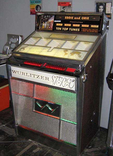

Wurlitzer 2700 Serie (1963)
W2700: 200 selections      |      W2710: 100 selections
W 2700
W 2710
Foto: Bernhard Wagner
  2700 2710
Wahlen / Selections 200 100
