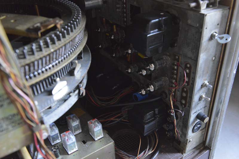

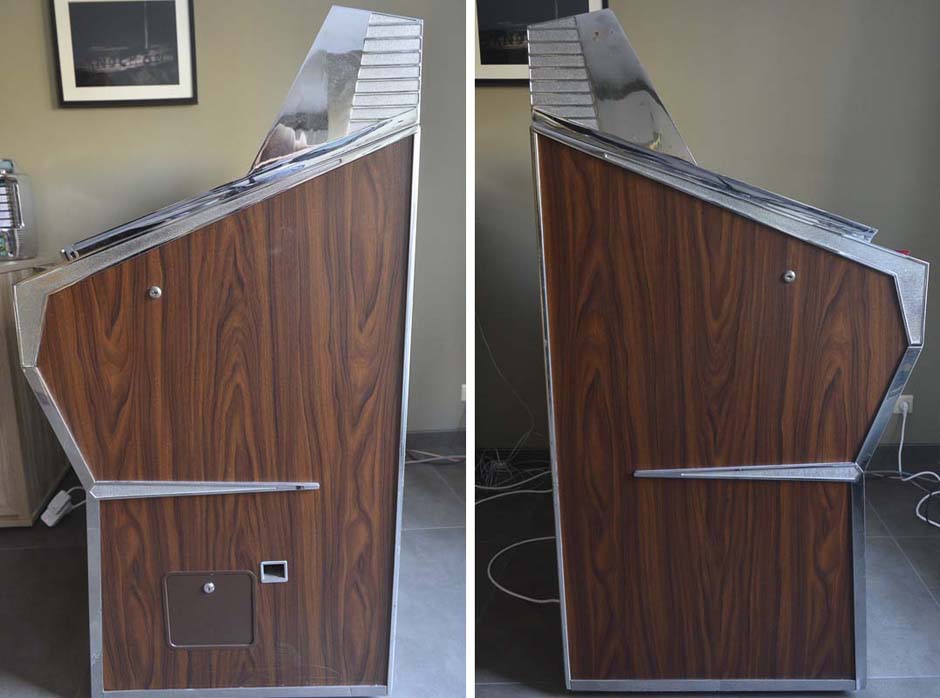

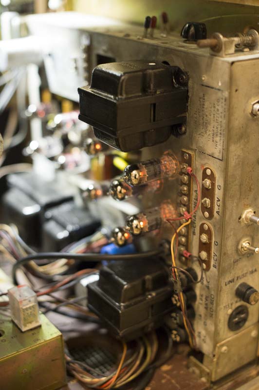

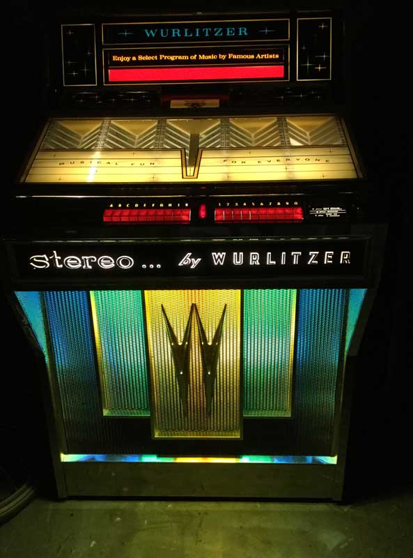

Wurlitzer 2800
Photos: Steven St.

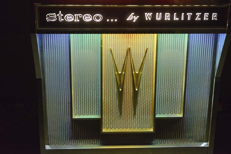

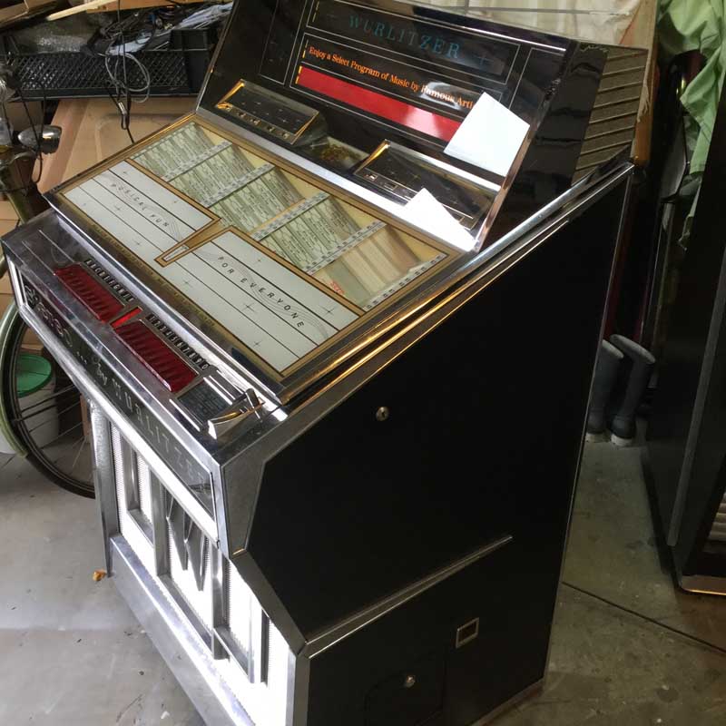

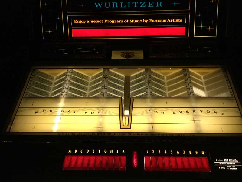

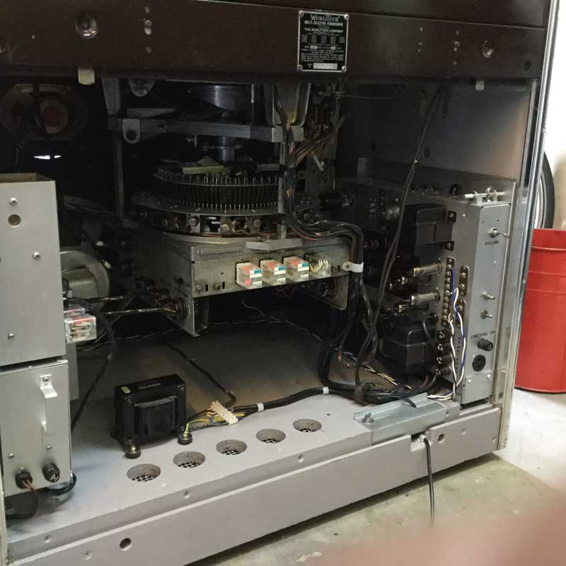

Wurlitzer 2810
Photos courtesy of Martin Knegt
