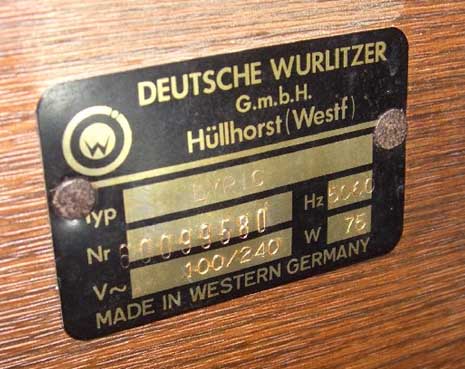

| Lyric (1981) |

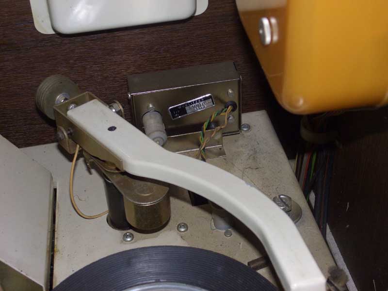

| Lautsprecher / Speaker | 2x 16Ω 15W |
| Tonabnehmer / Cartridge | Shure M75 (with pre-amplifier if needed, depends on amplifier) |

Regarding manuals and flyers published
by the Deutsche Wurlitzer no Lyric was produced in 1981. The shown version might be a limited customized version. Note that in this model a pre-amplifier is used with Shure M75 cartridge. Amplifiers built 1980 and later could be switched for use with either ceramic or magnetic cartridges. |
