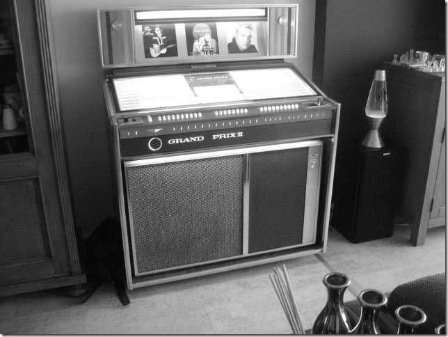

Rock-Ola 426
Grand Prix
2
(1965) 160 Wahlmöglichkeiten – Selections |
| Rock-Ola 426 - Grand Prix 2 |

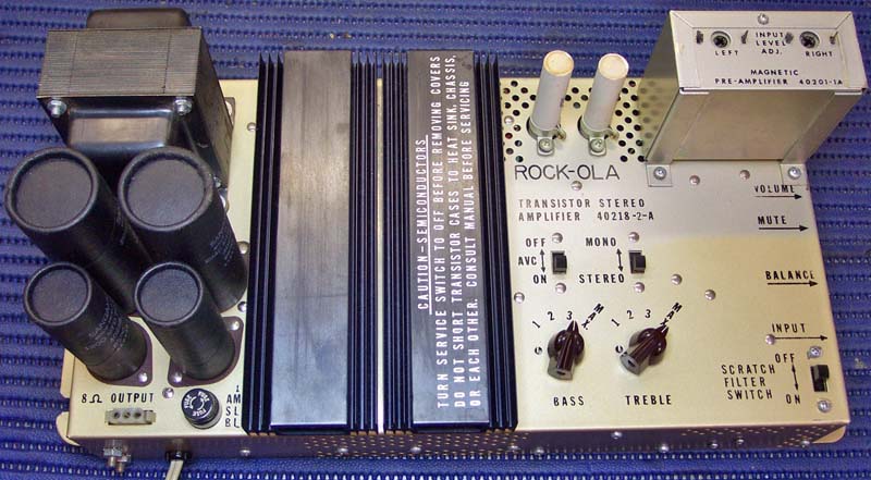

| Amplifier 40218-2A |
| Speaker Power Distribution Unit 40198-A |

| Verstärker / Amplifier |
40218-2A: Complete amplifier assembly incl. pre-amplifier 40201-1A 40276-2A: Transitorized stereo amplifier w/o pre-amplifier |
