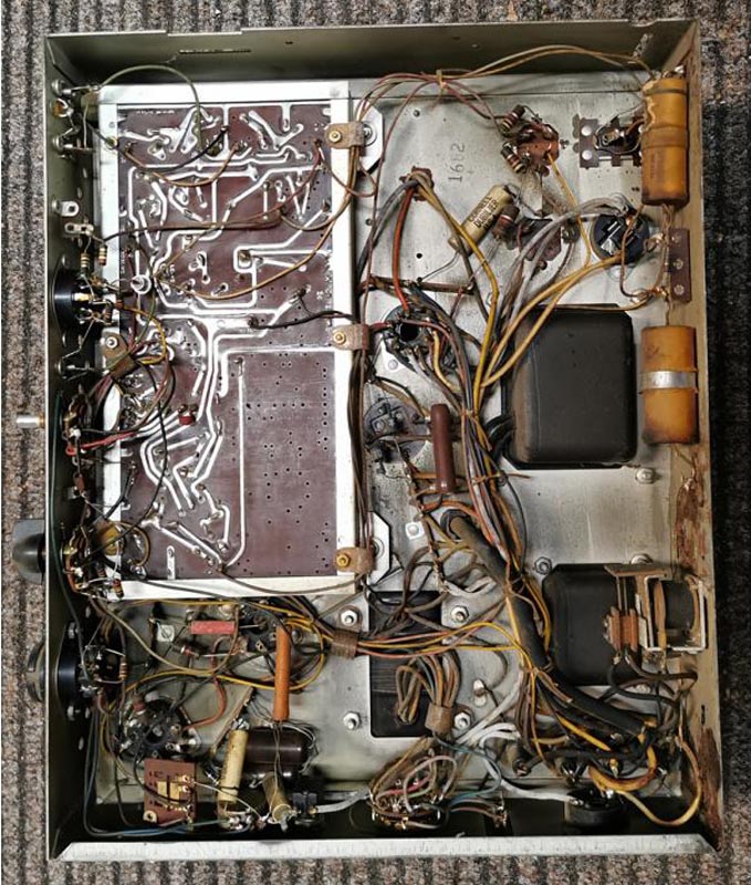

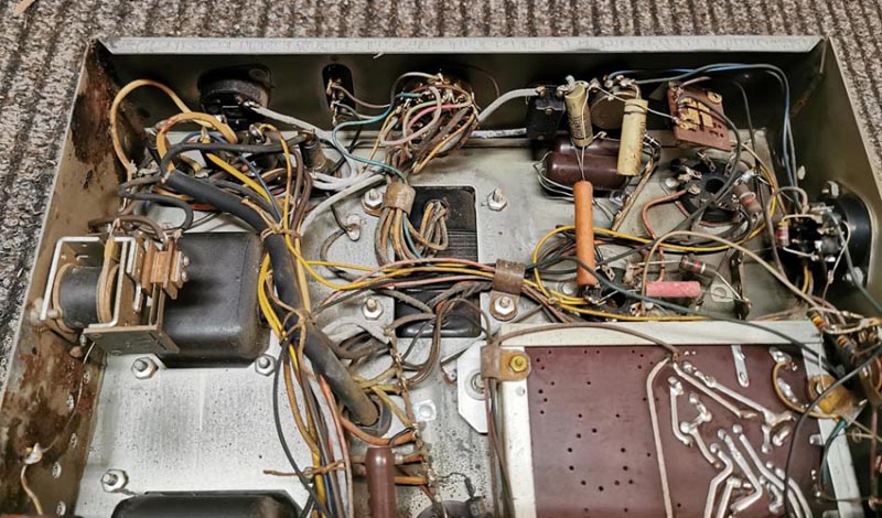

Photos 2504 courtesy
of
Thor Haugen Amplifier 540
– mono

| Verstärker / Amplifier |
540 (mono): 2x 7025, 12AX7, 12AU7, 2x 6L6 542 (stereo): 7025, 12AX7, 12AU7, 4x 6973 |
