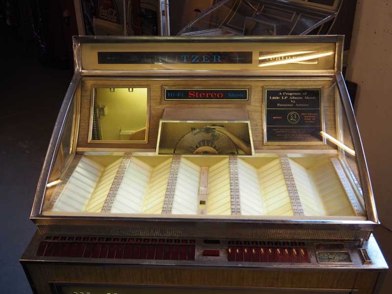

Model 2900
Wurlitzer 2900 - Copyright

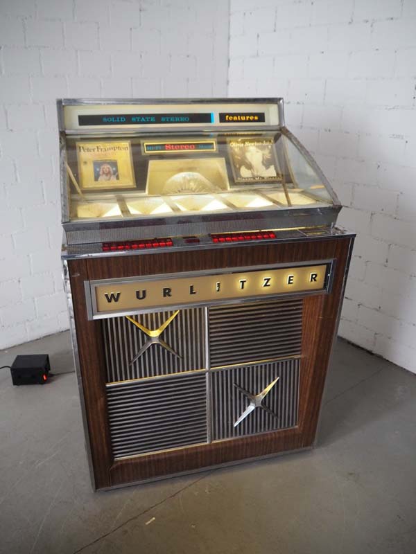

Model 2910: Dark cabinet, 100 Selections
Foto: Blackforest Warehouse
Wurlitzer 2910 - Copyright

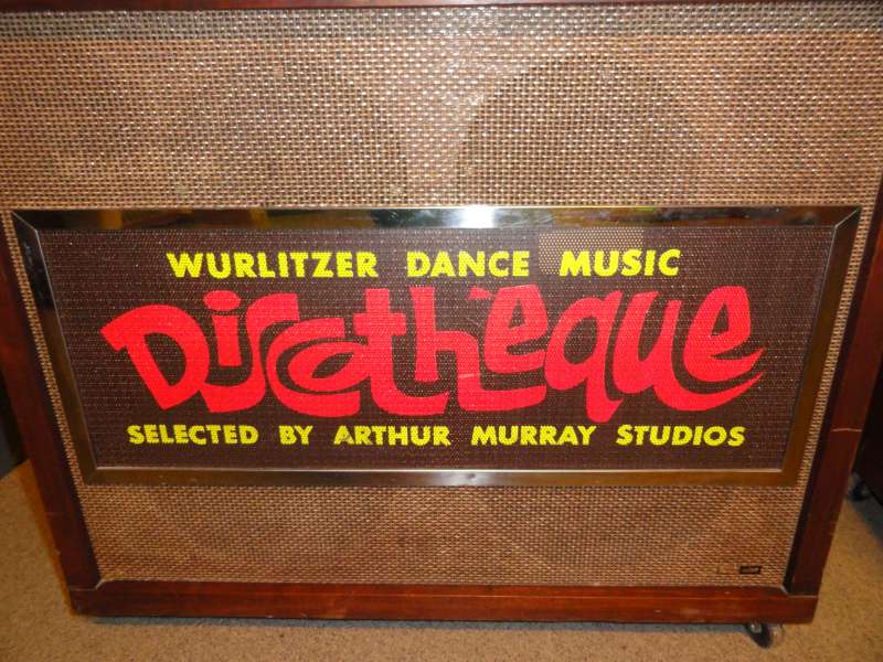

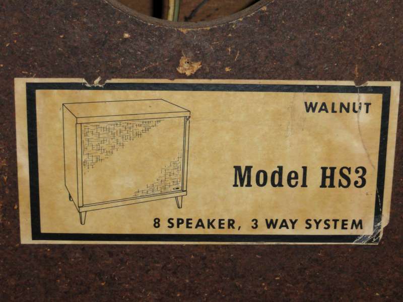

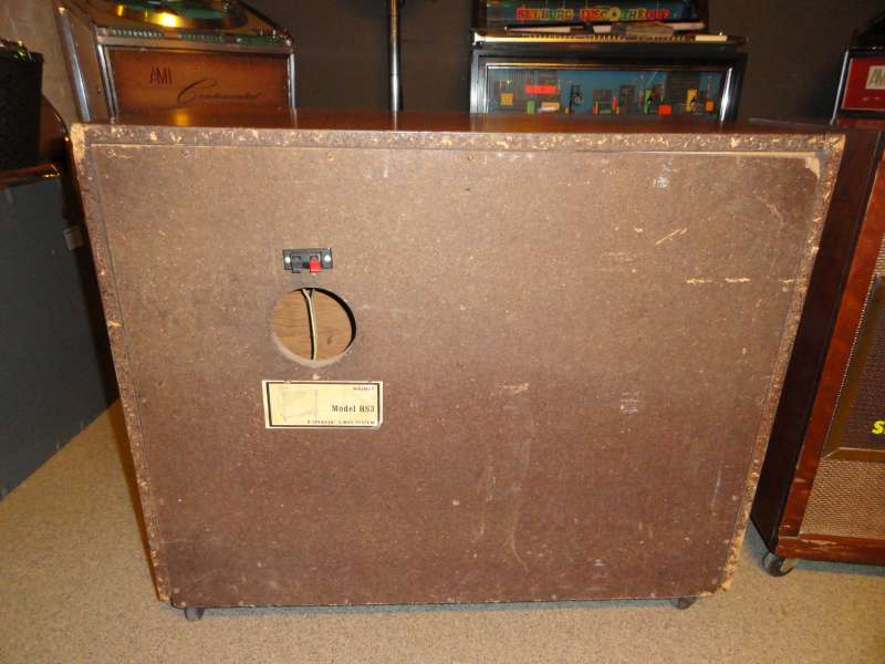

Utah HS3

Utah HS3

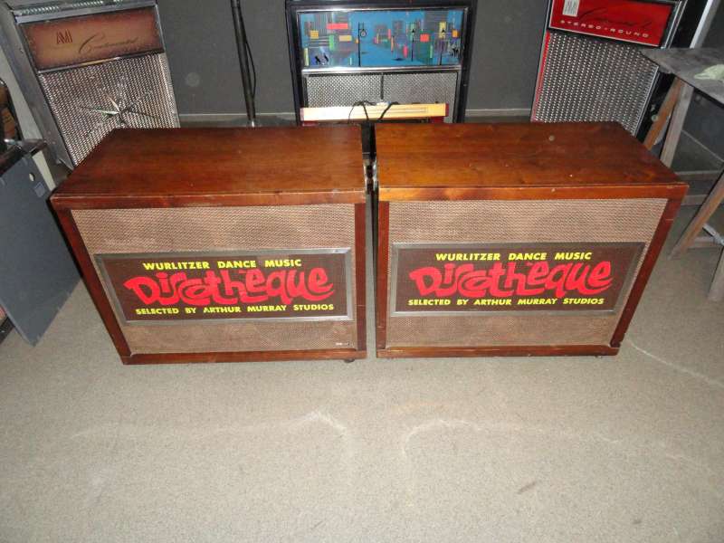

Besonderheiten / Features 2900-8: Discothèque Dancing Feature
Model 2900-8
Wurlitzer 2900-8 Discothéque - Copyright

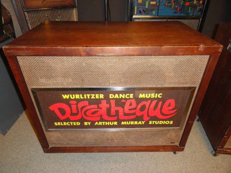

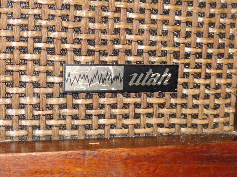

Extra Speaker HS3 by Utah
Wurlitzer 2900-8 Discothéque Utah HS3 - Copyright
