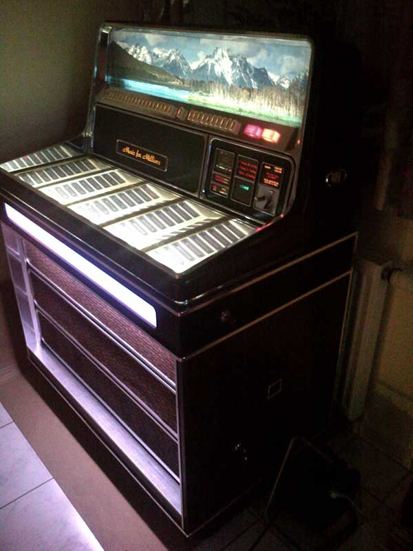

Wurlitzer 3400 Serie – Statesman (1970)
Wurlitzer 3400: 200 Wahlmöglichkeiten – Selections
Wurlitzer 3410: 100 Wahlmöglichkeiten – Selections
Wurlitzer 3460: 160 Wahlmöglichkeiten – Selections
Wurlitzer 3400
Wurlitzer 3400
Wurlitzer 3400
Wurlitzer 3400
Wurlitzer 3400
Wurlitzer 3400
Wurlitzer 3410
– sorry, no photo yet   –
Wurlitzer 3460
  3410 3460 3400
Wahlen / Selections 100 160 200

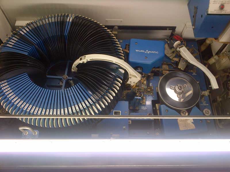

Mech control box: GE #305

Zubehör / Accessories Booster 222B; Microphone Kit 220; Kit 219
Stepper 265 (100/200 sel.)
Wallbox 5225 / 5225A (100 sel.)
Extra speaker Satellite II
Stepper 266 (160 sel.)
Wallbox 5220 / 5220A (160/200 sel.)

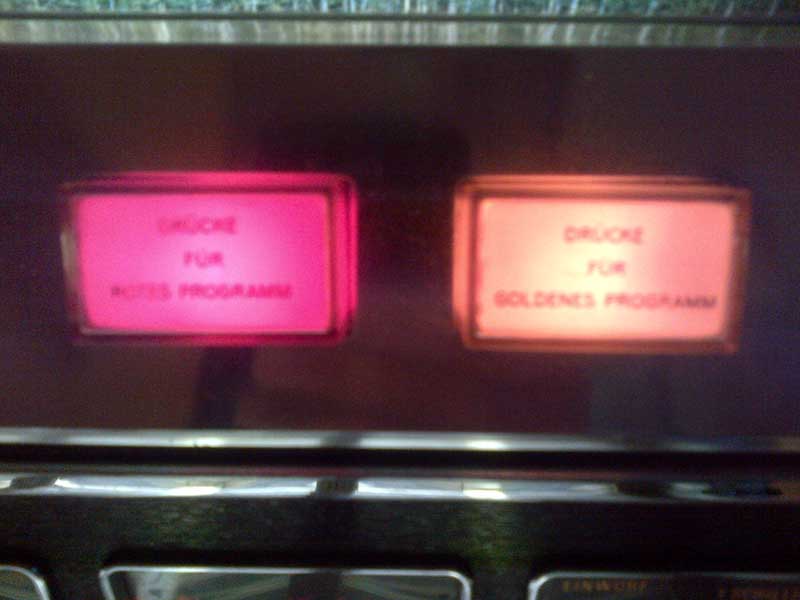

Besonderheiten / Features Golden and Red Program: 6 songs will be played when pressing either one of these buttons. Golden and Red Program: 6 songs will be played when pressing either one of these buttons. Golden and Red Program: 6 songs will be played when pressing either one of these buttons.
