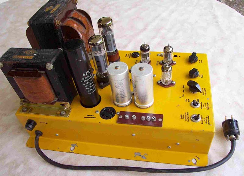

| NOVA Verstärker / NOVA Amplifier | |

| Verstärker / Amplifier | 30625-A: 6L6 GB (2); 12AT7; 6CG7 (2); 6BA6; 5U4GB or NOVA Amplifier with 3x ECC 83, EF 83, 2x EL 34 |
