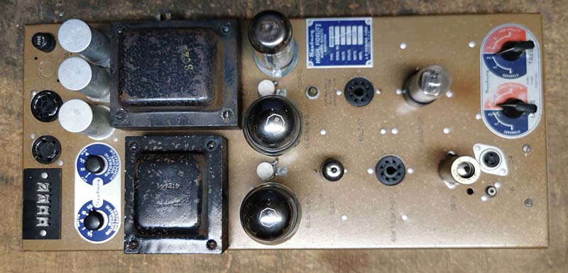

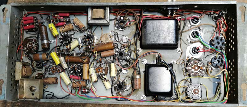

Seeburg Amplifier MRA4
Seeburg HF100G MRA4
Seeburg HF100G MRA4

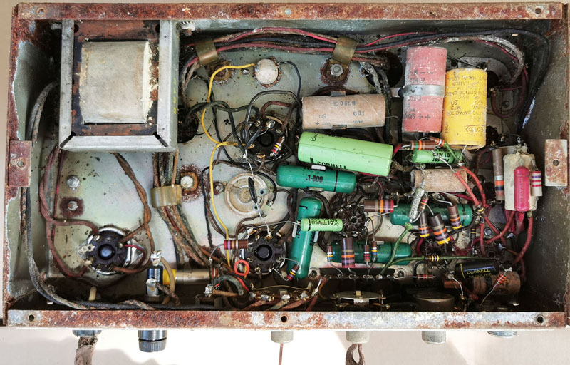

Seeburg Auxiliary Amplifier HFA1

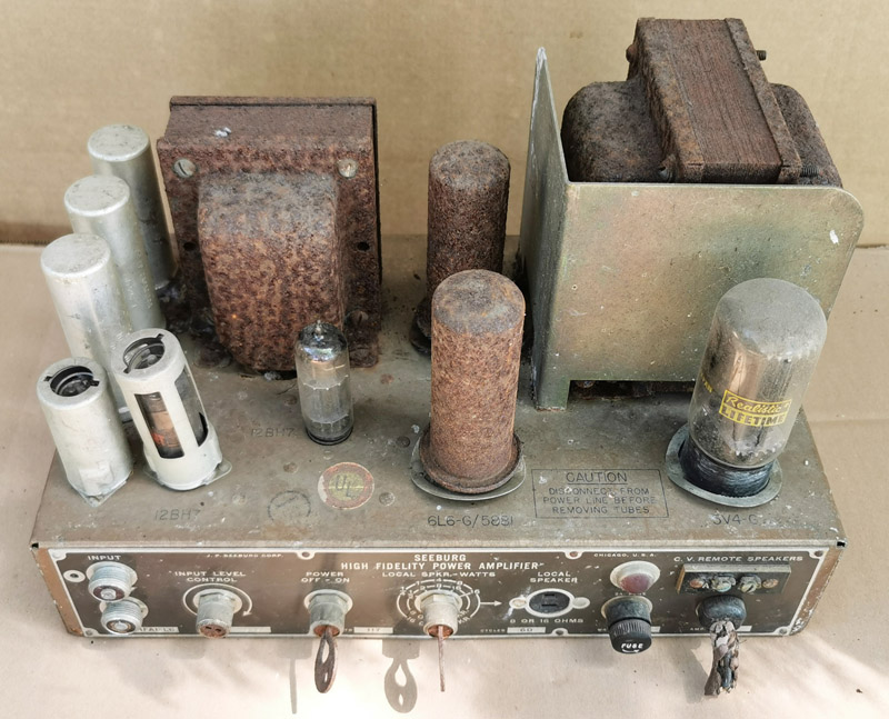

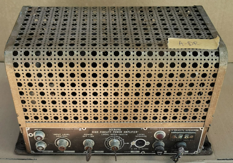

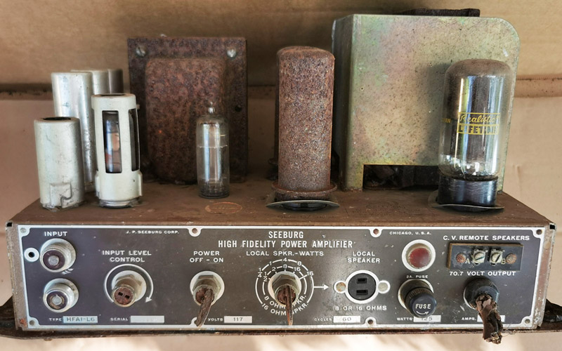

Seeburg Auxiliary Amplifier HFA1A
