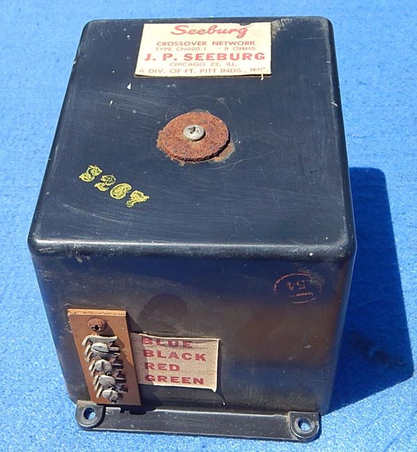

Crossover Network CN600-1
Photo courtesy Bill Butterfield
Seeburg Crossover Network CN600-1

Frequenzweiche / Crossover Network CN600-1 CN600-1
