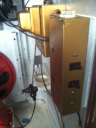

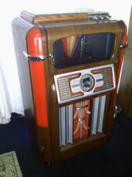

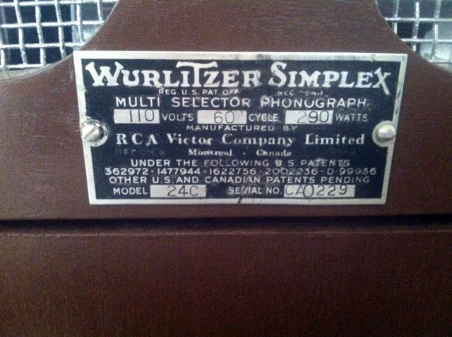

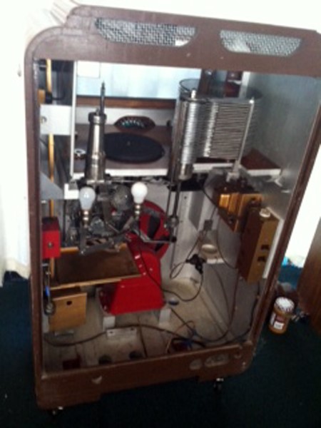

Model Wurlitzer 24C - Production in Canadian RCA Victor Company (1938)
Photos courtesy of David Brenner
Wurlitzer 24C Wurlitzer 24C
Wurlitzer 24C
Wurlitzer 24C
Wurlitzer 24C

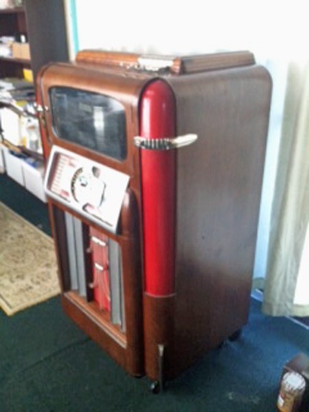

Miraben: Aftermarket  Wurlitzer 24A (1940)
Price: US$ 149.00; Light-Up Kit only: US$ 21.50
Wurlitzer 24 Miraben
