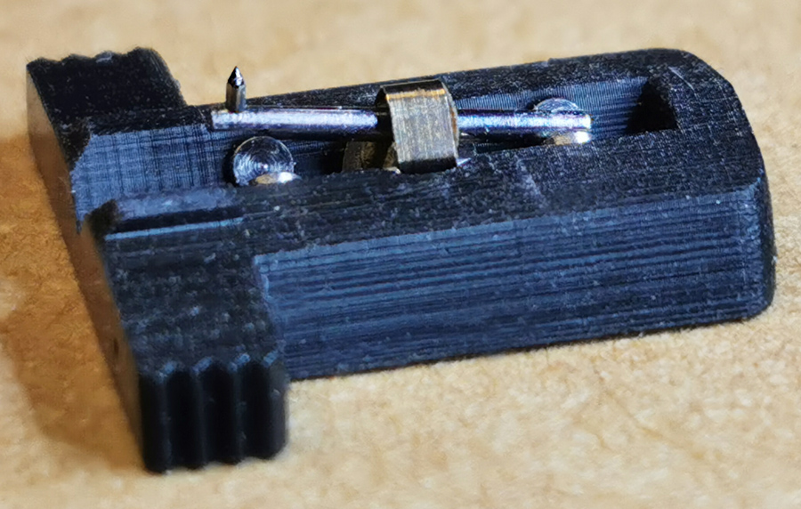

Diamond tipped for Seeburg 220, 222 (Channel) up to PFEA1U, APFEA (Elektra & Fleetwood)
Price each.
Cart deactivated
--- available soon ---
It took a long time to develope this needle in cooperation with the manufacturer. The result is as needle with a high output. The bass is full and the trebles are clear.
This diamand tipped needle was used in Seeburgs first stereo jukeboxes from 1958 to 1965. It replaces the originally used blue (sapphire) and grey (diamond) needles.
  • Channel: 220, E220, 222, E222
  • Q100, Q160, AQ100, AQ160, EQ100, EQ160
  • AY100, AY160, EAY100, EAY160, Y100, Y160, EY100, EY160
  • DS100, DS160, EDS100, EDS160
  • LPC1, ELPC1
  • LPC480, ELPC480
  • Mustang: U100, EU100, U100D, EU100D
  • Elektra & Fleetwood: PFEA1U, EPFEA1U, APFEA, EAPFEA
Note: The needles are manufactured for a tone arm weight of 6 grams.
Next to the correct pressure it is very important that the tone arm is balanced right (according to the instructions given in the service manuals).
